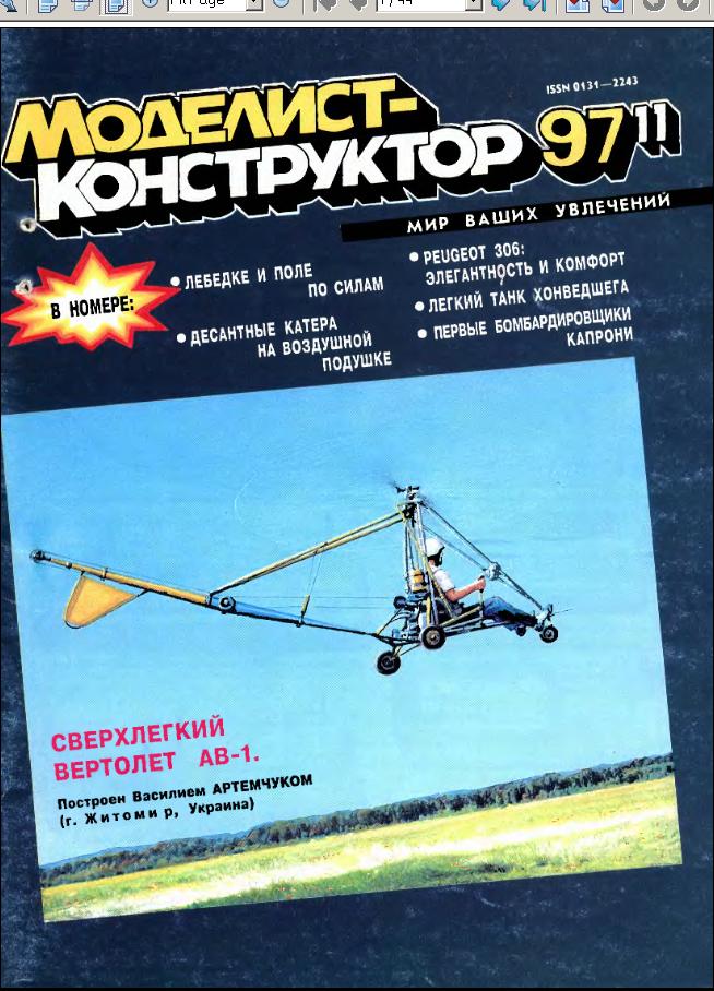

No problem. I have a couple of pictures like those I've posted above, but in bigger resolution. I made it in June last year. Do you need it still? [/quote]
Yes please Andreas !!
Any picture of homebuilt helicopters are very welcome.
Thanks,
regards
Gilbert
For good guys we are generous people 🙂
    103,8 КБ · Просмотры: 259
    130,2 КБ · Просмотры: 251
    144,1 КБ · Просмотры: 253
Next
    132,9 КБ · Просмотры: 229
    161 КБ · Просмотры: 243
    147,8 КБ · Просмотры: 253

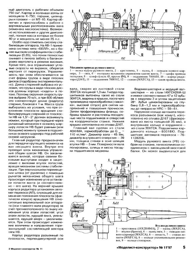

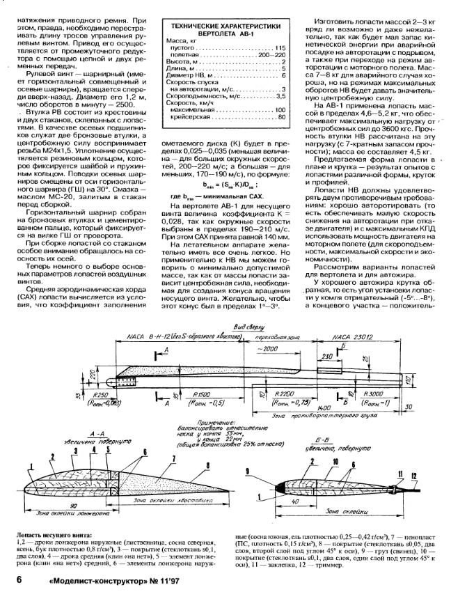

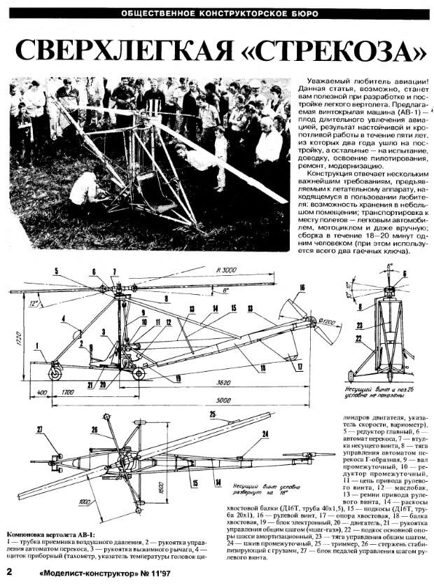

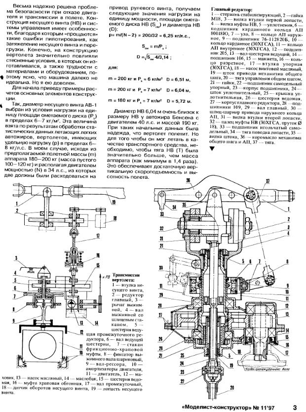

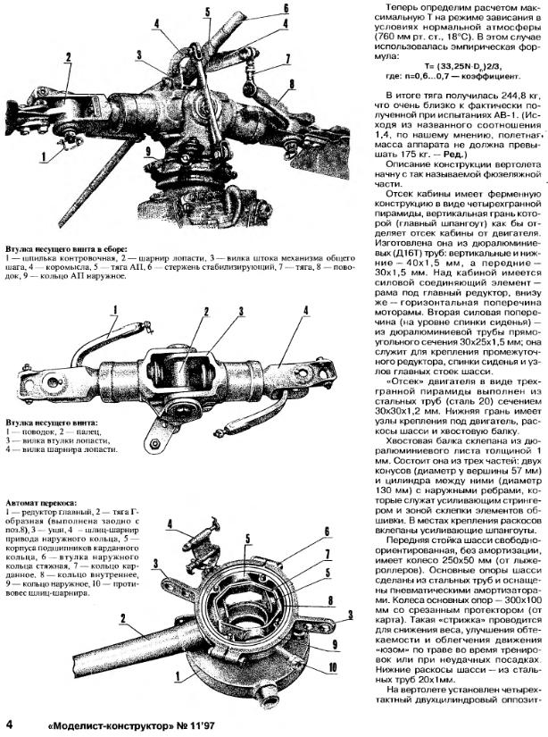

THANKS..Thanks..thanks !!!!!!!
As allways,it's more complex than I thought but I'm not an engineer.
I have no idea what is been written in the article but the pictures and numbers are self explaining to an extend.
Rotordiameter:6 meter
Max speed: 100 km/h
Cruising: 80 km/h
Tip speed :200 m/s
Rotor solidity ratio:0,028
I hope that my "translation" is correct (now that would surprise me !!)
Going to study the drawings and pictures to find out how the cyclic/collective system is working.
Thanks again !!!
regards,
Gilbert
