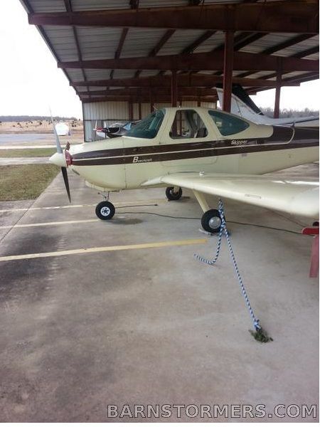

Появился такой:
    52,4 КБ · Просмотры: 203
BEECH SKIPPER 1980 $41,000
Beech Skipper--293 SMOH, 4279 TT.
General characteristics
    Crew: 2
    Length: 24 ft 0 in (7.32 m)
    Wingspan: 30 ft 0 in (9.14 m)
    Height: 7 ft 11 in (2.41 m)
    Wing area: 129.8 ft[ch178] (12.1 m[ch178])
    Airfoil: GA(W)-1
    Empty weight: 1,100 lb (499 kg)
    Max. takeoff weight: 1,675 lb (760 kg)
    Powerplant: 1 [ch215] Lycoming O-235-L2C flat-4 engine, 115 hp (86 kW)
Performance
    Cruise speed: 105 knots (121 mph, 195 km/h)
    Stall speed: 47 knots (54 mph, 87 km/h) (flaps down)
    Range: 412 nmi (475 mi, 764 km)at 8,500 ft (2,600 m) (econ cruise)
    Service ceiling: 12,900 ft (3,930 m)
    Rate of climb: 720 ft/min (3.65 m/s)
