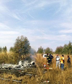

Цитирую без перевода:
Three killed in Mpumalanga helicopter crash      August 30 2009 , 5:40:00
Three people died late this morning when their chopper crashed in the Heidelberg valley outside White River Mpumalanga. The pilot, a Nelspruit business man and his two passengers were on their way home from Klaserie in Limpopo when the accident occurred.
George Snyman's yellow helicopter was regularly seen flying in the Heidelberg valley. People that live in the area say he used to land there sometimes for a short visit. Snyman is a well known home chopper builder of Nelspruit.
Just before 10am this morning residents of the nearby informal settlement heard a loud crash. Shortly after - a fire starting burning in the plantation and when they went to investigate they found the wreckage of the chopper.
A team from the Red Cross Air Mercy Services was sent to the crash scene. They found that Snyman and two little girls Cindy Nel and Zandri Germishuis had not survived.
The burning helicopter set the grass and plantation around the scene on fire and teams from Working on Fire had to be called in to extinguish the flames. Civil Aviation was sent to investigate the cause of the crash. The bodies will be taken to Pretoria for forensic tests.
August 30 2009 at 03:14PM
A 49-year-old pilot and two young girls were killed when their private helicopter crashed in White River, Mpumalanga on Sunday, police said.
The aircraft fell to the ground and exploded near a Eucalyptus tree plantation, Superintendent Abie Khoabane said.
The pilot was identified as George Snyman and the girls as 11-year-old Cindy Nel and eight-year-old Zambrie Germishuizen of Nelspruit.
"The three were burnt beyond recognition. We do not known what happened because there were no witnesses."
The SABC reported that the accident caused a fire in the plantation, which Working for Fire was helping to put out. Civil Aviation Authority representatives were expected at the scene later. The bodies would be taken to Pretoria for post mortems.

Произведено 30 ветолетов, если инфа о ЮАР верна, то это 4 авария, 2 из них случились по вине пилота, по двум другим транспортная прокуратура внятного заключения не дала......
А это два года назад в той же африке - обошлось без жертв…
http://aviation-safety.net/wikibase/wiki.php?id=46130

Да, это был санька…извините, опять без перевода...
Kinders dood n[ch225] heli val en brand
2009-08-30 22:33
Buks Viljoen
Twee maatjies van 8 en 11 jaar oud is gisteroggend saam met ’n vlie[ch235]nier dood toe die helikopter waarin hulle was om ’n onverklaarbare rede buite Witrivier neergestort het.
Die oorledenes is mnr. George Snyman (49), ’n bekende Laeveldse helikopter-geesdriftige, Zambrie Germishuyzen (8) en Cindy Nel (11).
Zambrie se ma, me. Ina Germis­huyzen, is Snyman se verloofde.
Een van die meisies het glo op die ander se skoot in die tweesitplek-Sanka-helikopter gesit.
Daar was blykbaar voor die ongeluk geen teken dat Snyman probleme met die helikopter ondervind het nie.
Hy was minute voor die ongeluk nog in radioverbinding met die beheertoring van die Kruger-Mpumalanga- Internasionale Lughawe (KMIA).
Die helikopter het omstreeks 09:45 in ’n grasveld in die Heidelbergvallei tussen Witrivier en Nelspruit naby ’n bloekomplantasie geval.
Die helikopter het aan die brand geraak en al drie die insittendes het verkool.
Supt. Abie Khoabane, polisiewoordvoerder, het ges[ch234] mense wat naby die ongelukstoneel woon, het ’n slag gehoor en toe rook gesien.
Snyman, jare gelede hoof-tegniese offisier in die lugmag in Hoedspruit, was die eienaar van ’n swembad-onderneming in Nelspruit en was glo vir die dag Klaserie toe vir werk.
Die twee meisies, glo beste maatjies, het saam met hom gevlieg.
Die ongeluk het met die terugvlug gebeur.
’n Huisvriendin van Cindy se ouers, mnr. Jan en mev. Alida Nel, het gisteraand aan Beeld ges[ch234] daar is baie verwarring by die gesin oor hoe die ongeluk gebeur het.
Die ouers was nog te geskok om met Beeld te praat.
“Dit gaan glad nie goed met Jan en Alida nie. Hul harte is stukkend,” het die vriendin, wat anoniem wou bly, ges[ch234]. Sy was in daardie stadium by die Nel-gesin aan huis.
Cindy was ’n gr.?6-leerling aan die Laerskool Laeveld in Nelspruit. Haar enigste sussie, Bianca (10), is ook in di[ch233] skool.
Germishuyzen was ook nog te geskok om oor die dood van haar dogtertjie en verloofde te praat.
Amptenare van die Burgerlugvaart-owerheid was gisteraand steeds op die toneel besig met die ondersoek.
Die lyke is vir patologiese toetse na ’n lykshuis in Pretoria geneem.
Snyman was ’n lid van die Lowveld Aero Club en het self helikopters gebou.
Hy het ’n paar jaar gelede drie Oekra[ch239]ens vervaardigde Sanka-helikopters ingevoer.
Een van di[ch233] helikopters het in Oktober verlede jaar uitgebrand toe dit ’n noodlanding op ’n wildplaas buite die Sabi-Sabi-wildtuin moes uitvoer.
Die vlie[ch235]nier van di[ch233] tuig, mnr. Dirk Bekker, het destyds ongedeerd daarvan afgekom.
