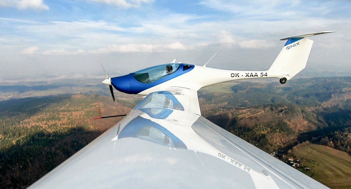

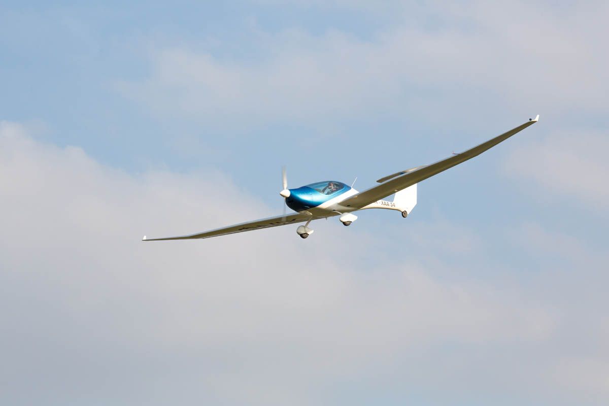

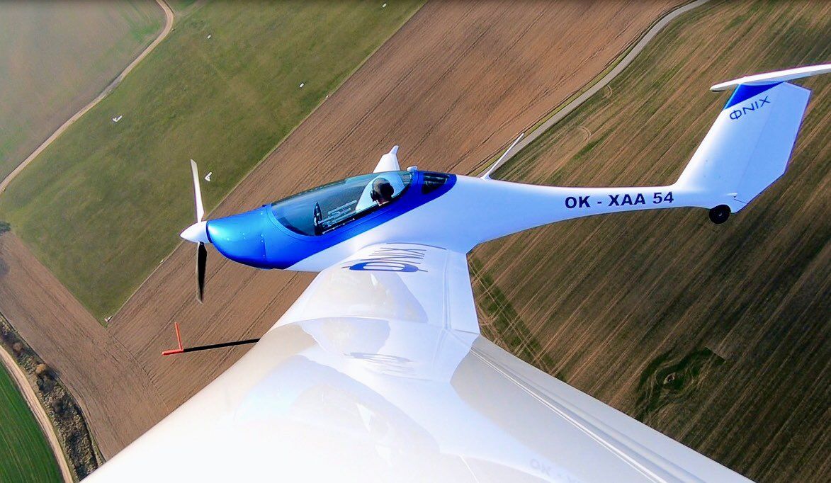

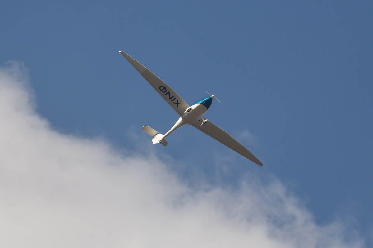

Finally we did a test flight 🙂
60 kW electric motor, 35 kWh battery, endurance over 2,5 hours with reserve...

Very good weight estimation 🙂
35kWh battery = really approx. 150 kg.
We replaced weight or Rotax 912 in the front (70 kg battery + electric motor, controller, cooling system etc.) + 2x 40 kg battery in wings, replacing 50 litters of fuel in each fuel tank. I wanted to precede problems with CG.
According to data downloaded from controller seems that will be possible to keep horizontal flight with 10 kw of power.
But a lot of meaurements is still in the front of us...
Have a great day!
Martin

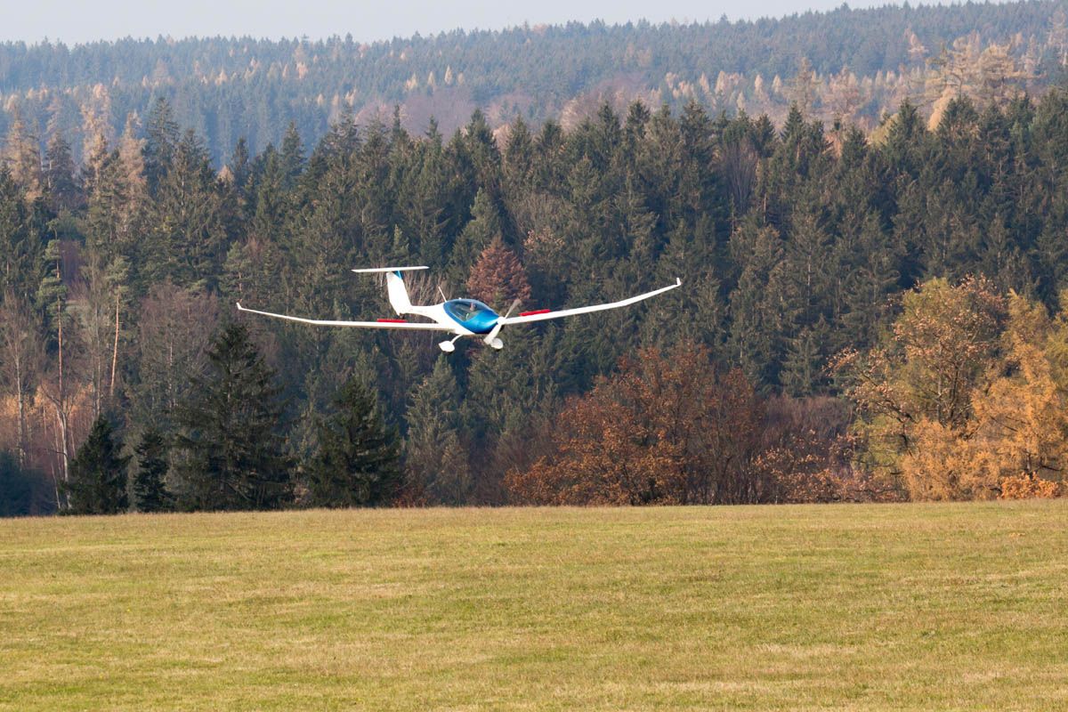

    139,5 КБ · Просмотры: 165
    104 КБ · Просмотры: 175

Hello Raven!
Propeller is 1,6 Varia from Woodcomp. Actualy we have no adjustable mechanism finished, but plan is to have in flight adjustable and feathering possibility.
Best regards!
Martin
