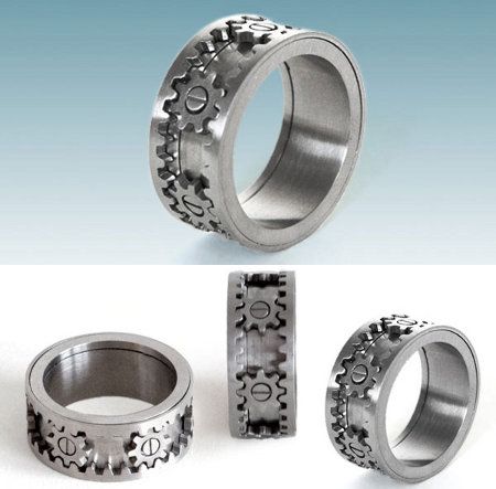

http://www.omega7red.com/tag/gear-ring/
-intieriesnyj princip...
