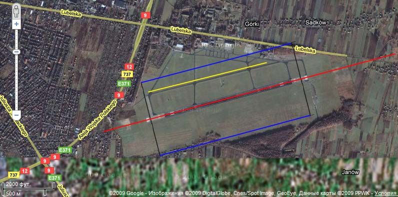

Ниже я покажу графически какие существуют требования и что было на самом деле.
На фото аэродром в Радом с разметкой синими линиями для зрителей при полетах ВС категории I. Красным "линия показа" (show line) для ВС категории I. Желтым "линия зрителей" на удалении около 1000 футов от show line, что слишком мало для ВС категории I.
ЗЫ. Желтая линия восстановлена по видеоматериалам, обсуждавшимся выше.

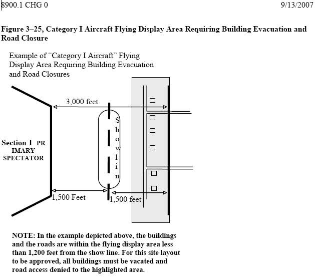

Требования по эвакуации из зданий и закрытия автодорог при полетах ВС категории I.
19) Flying Display Area. The airspace at an airshow where participating aircraft are authorized to perform. This area includes all the aerobatic boxes and show line but does not include ingress/egress routes (see Figures 3-24 and 3-25).
35) Show Line. A readily visible reference line that provides the required distance from the spectators for Category I airplanes that enhances pilot orientation during the performance. Category I airplane teams or solos should be oriented over or along this line during aerobatic maneuvers (see the note under subparagraph 3-147A).
3-147. MINIMUM SAFETY DISTANCES AND ALTITUDES.
This paragraph provides the minimum safety distances, both horizontal and vertical, which must be maintained between aircraft in flight and the primary spectator area, secondary spectator area, congested areas, and occupied buildings during an airshow.
A. , Reference Lines, And/Or Show Lines. For aerobatic and other flight demonstrations, an aerobatic box, reference lines, and/or show lines must be established at prescribed minimum distances from the designated spectator areas. These lines must be easily identifiable by the appropriate performers.
NOTE: There has been a change in terminology due to the previous terminology lending itself to performers flying too closely to the designated spectator areas. Previously, all minimum distance lines were referred to as show lines. Many performers centered their aircraft on the line appropriate for their category. This is appropriate only for Category I airplanes. Category I show lines should be the center of the lead Category I airplane and/or formation. Category II airplanes and all helicopter aerobatics, Category III, and flyby lines are not to be overlapped by any portion of any aircraft required to operate at that minimum distance from the designated spectator areas. To be more descriptive of restrictions, only the 1,500-foot (at times will be reduced to 1,200 feet) line will be referred to as a show line. The 1,000-foot (at times 800 feet) line and the 500-foot line will be referred to in this Chapter as reference lines that are not to be crossed or used as a center line for an aerobatic performance or flyby. They are lines that denote the minimum distance for all portions of all aircraft to be beyond, not on. The Category II and Category III aerobatic areas have to provide enough airspace to complete all aerobatic maneuvers. To do this, they must have length and width described herein as an aerobatic box. All nonaerobatic flybys only need a reference line to stay beyond 500 feet from the designated spectator areas. This is the same line as the edge of the Category III aerobatic box and may not be reduced in distance from the designated spectator area(s).
Теперь вопрос - В каком месте на карте проходил последний маневр Су-27, если он коснулся земли за лесом и что он там делал?
Когда я пишу о недостаточной подготовке, я имею ввиду прежде всего незнание правил или их невыполнение. Это касается как Львовского авиашоу, так и Польского. Я был шокирован, когда Gennady показал мне в аэропорту Львова где что было расположено во время авиашоу :STUPID. Эти два авиашоу на самом деле очень похожи ИМХО, только в этот раз обошлось без жертв среди зрителей. С перепугу после Львовской катастрофы полеты стали относить далеко за пределы ВПП, вылезая на расположенные там гражданские объекты  :STUPID, а о направлении выполнения фигур пилотажа что-то никто не задумывается.

Чуть правее полосы означает - НА СТОРОНУ ЗРИТЕЛЕЙ! Это запрещено!
Теперь обратите внимание на видеозапись в ответе №3. Выход из перевернутого полета предыдущие разы около 12 секунд (1:25-1:37, 1:48-2:00, 2:10-2:22), а в последний раз видимая часть полёта всего 8 секунд (2:50-2:58). Там явно не хватало высоты.
