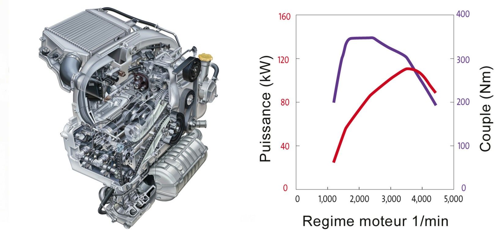

Maximum output: 110 kW (150 PS)/3600 rpm
Maximum torque: 350 Nm (35.7 kgf·m)/1800 rpm

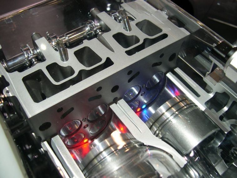

The engine has a ‘square’ bore and stroke of 86 mm and a compression ratio of 16.3:1. Compared to Subaru’s 2.0-liter gasoline engine fitted to the Impreza, Legacy and Forester, the 2.0-liter Boxer Diesel has a 11 mm longer stroke and 6 mm smaller bore for a capacity of 1,998 cc versus 1,994 cc.
Thanks to a bore pitch shortened from 113 mm to 98.4 mm, the overall engine block length is only 353.5 mm compared to the gasoline version’s already compact 414.8 mm.

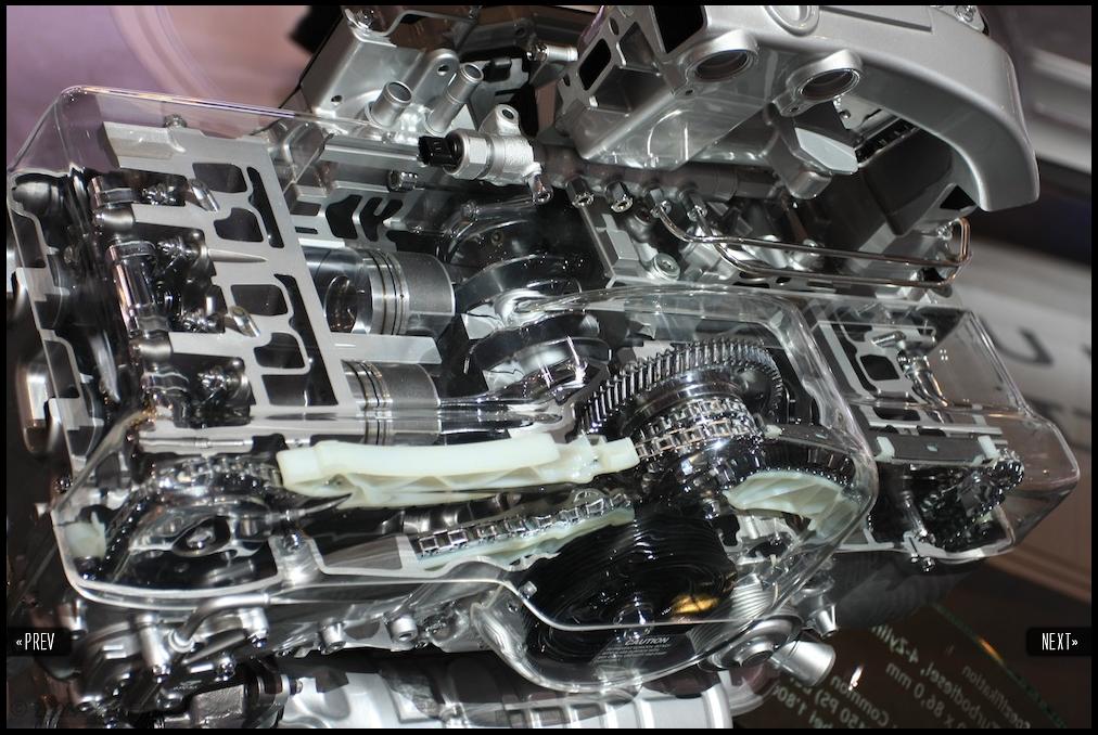

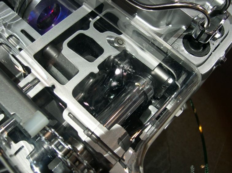

The block is of a rigid semi-closed deck design, while all five main bearings in the alloy cylinder block use metal composite supports for added strength and durability. It also enhances refinement, providing a similar thermal expansion to that of the crankshaft.
композитная структура блока - встроенные суппорты (из стали скорее всего)

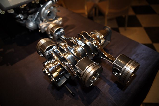

Extra water-cooling slits have been added between the cylinder bores and the high-strength pistons are squirted with oil to enhance cooling. The large ends of the connecting rods feature an asymmetrical profile for assembly precision and reduced friction.
дополнительные каналы охлаждения между цилиндрами, поршень также охлаждается маслом

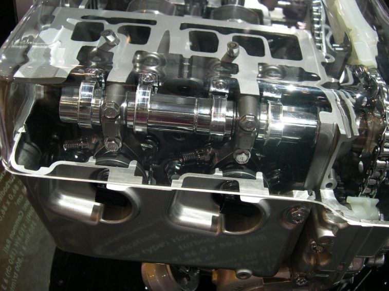

The high-strength crankshaft has a special surface treatment to withstand the diesel engine’s high combustion pressures while the uprated cylinder heads have roller rocker arms. In addition, the cam-drive is via a chain system that better handles the variations in torque of a diesel engine.
специальная обработка коленвала

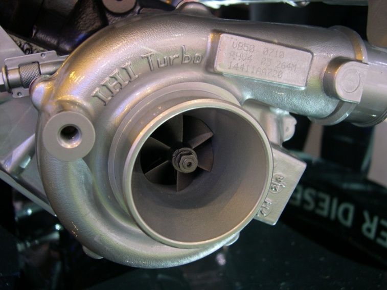

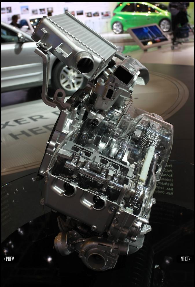

The new Boxer Diesel uses an advanced 180 MPa (1,800 bar) common-rail fuel-injection system. Special, short-length solenoid injectors ensure the engine’s width is no greater than that of the 2.0 litre boxer gasoline unit, despite the diesel’s longer piston stroke.
The variable nozzle turbocharger ensures the correct boost throughout the engine’s rev-range and its low center-of gravity position under the engine and close to the catalytic converters increases environmental performance.

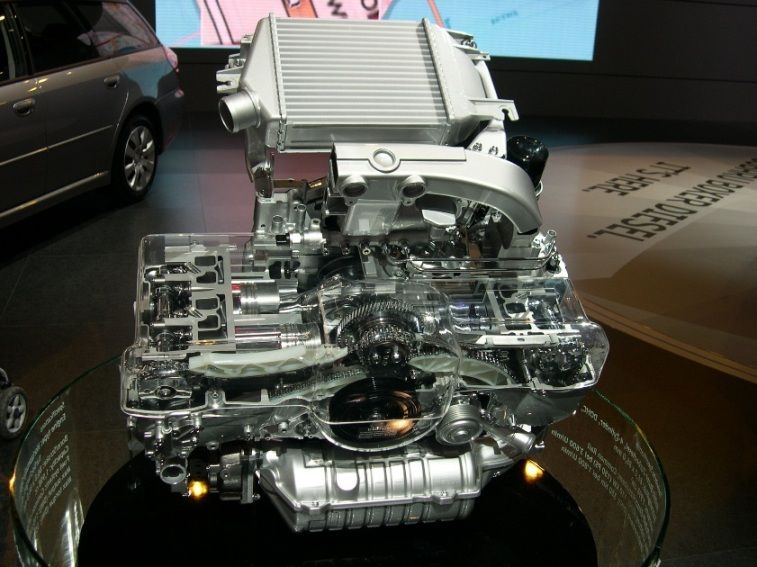

    43,4 КБ · Просмотры: 248

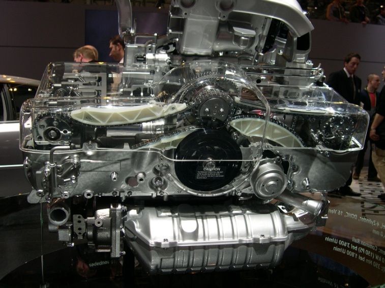

и сердце мотора
    40 КБ · Просмотры: 266

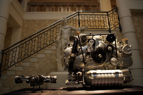

и мааааленькое фото виновника торжества  :🙂

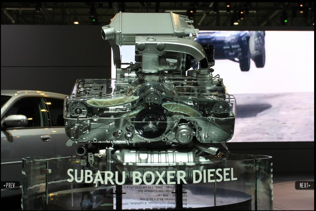

    39,4 КБ · Просмотры: 267
    96,9 КБ · Просмотры: 264
    94,9 КБ · Просмотры: 246
    128,3 КБ · Просмотры: 250

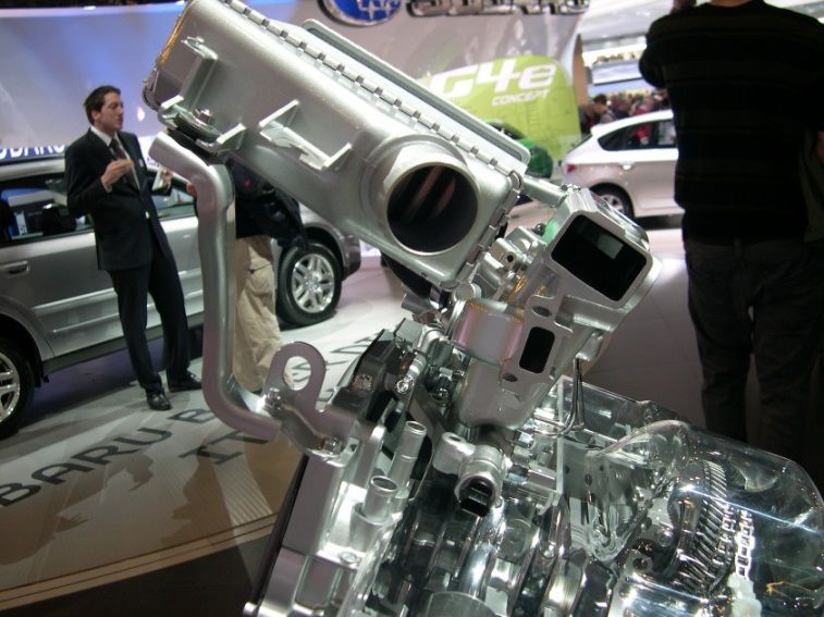

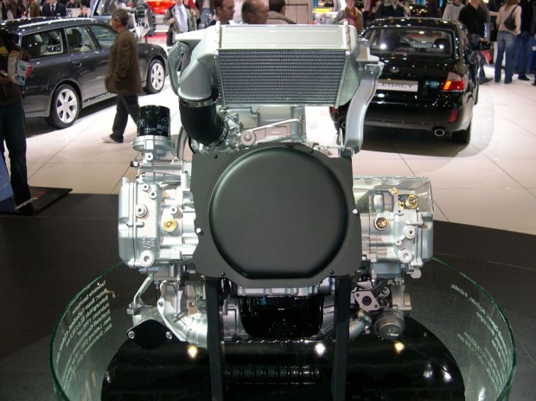

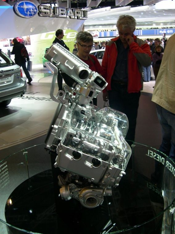

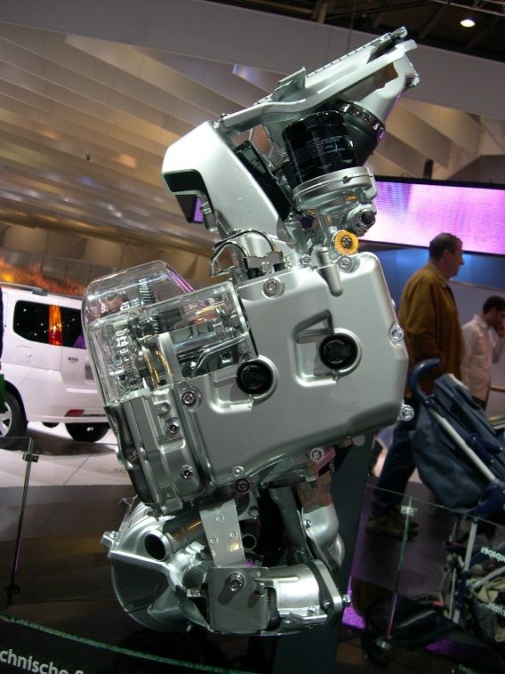

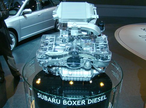

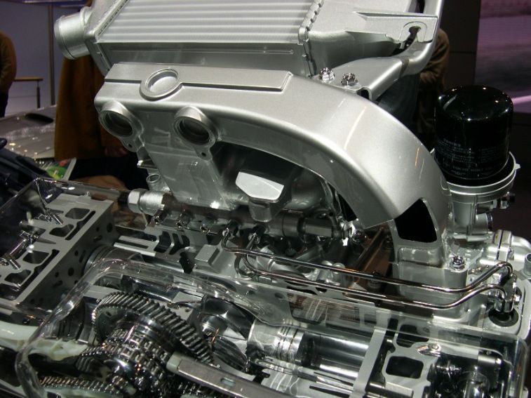

итак, удалось лично познакомится с двигателем на выставке
    78,6 КБ · Просмотры: 282
