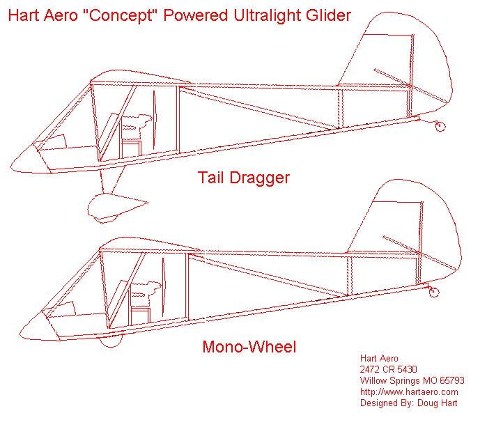

Оставьте вы этот "вчерашний день" под названием "Коршун"- вот более современный аппарат для превоначального обучения и будет летать с двжком Tecumesh лошадок 6 всего и весом 90 кГ. Посадочная скорость..... 18 миль/час это то что надо
http://www.hartaero.com/turkeybuzzard.html
Заодно концепт над которым ведутся работы сейчас.
S P E C I F I C A T I O N S U L T R A L I G H T G L I D E R
Wing Span -- 38 feet
Wing Area -- 168 square feet
Length -- 19 feet
Empty Weight -- 155 pounds (mono wheel)
Max Gross Weight -- 425 pounds
Max Pilot Weight: 245lbs
Best Glide Ratio -- 18:1 at 33mph***
Best Sink Rate -- 180 feet/minute at 33mph***
Max Speed -- 65 mph
Stall Speed-- 20 mph
Limit Load -- +6.4 G and -3.4 G
Ultimate Load (Structural failure)-- +12.8 G and -6.8 G
Max Wind component: 15mph
**Full Span flaperons will be standard equipment.
***Lighter than 245lb pilots will be able to acheive a higer L/D and a
better minimum sink rate.
Quick assembly kit price: $2995.00
Wings, fuselage, tail, flight controls all prebuilt, fitted,rigged and
ready for cover. Builder must install choice of tow release.
Ready to fly: $3550.00
Completed and painted with your choice of 1 color base and 1 stripe.
Custom paint schemes available at extra costs. Choice of ground tow
release or aero tow hook realease. Add $200 for both release options.
Options:
Power Pod: This is still on the drawing board, and will become an
option as soon as a suitable powerplant is found. We will need a
minimum 10hp engine to produce a 300fpm climb and a 650ft takeoff over
50ft obstacle. Takeoff roll would be about 150ft. Something of very
high consideration is using a Briggs type 4 cycle engine. It would be
within weight limits and able to provide a very cost effective means
and provide 4 cycle noise level and miserly fuel consumption (about 2
hours on 1 gallon of gas!). Please post your thoughts. Max
engine/prop weight would have to be 55lbs or less to be able to load a
max pilot weight of 210lbs.
Tricycle gear option for use with power pod: A simple tricycle gear
option will be offered for use with the power pack.

Stas, а по мне так несурьёзная конструкция: то-ли ферма, то-ли две балки, колесо - только половина (другая в заднице пилота), винт диаметром с полметра.
Беркут по мне грамотнее...  ;)
Кестас.
А чем плоха половинка колеса? На первый взгляд меньше сопротивление. И заднице теплее от трения  ;D

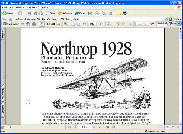

Для всех любителей классики
http://www.ultraligero.net/Sitios/Planos/Northrop_1928/Northrop_1928.pdf
