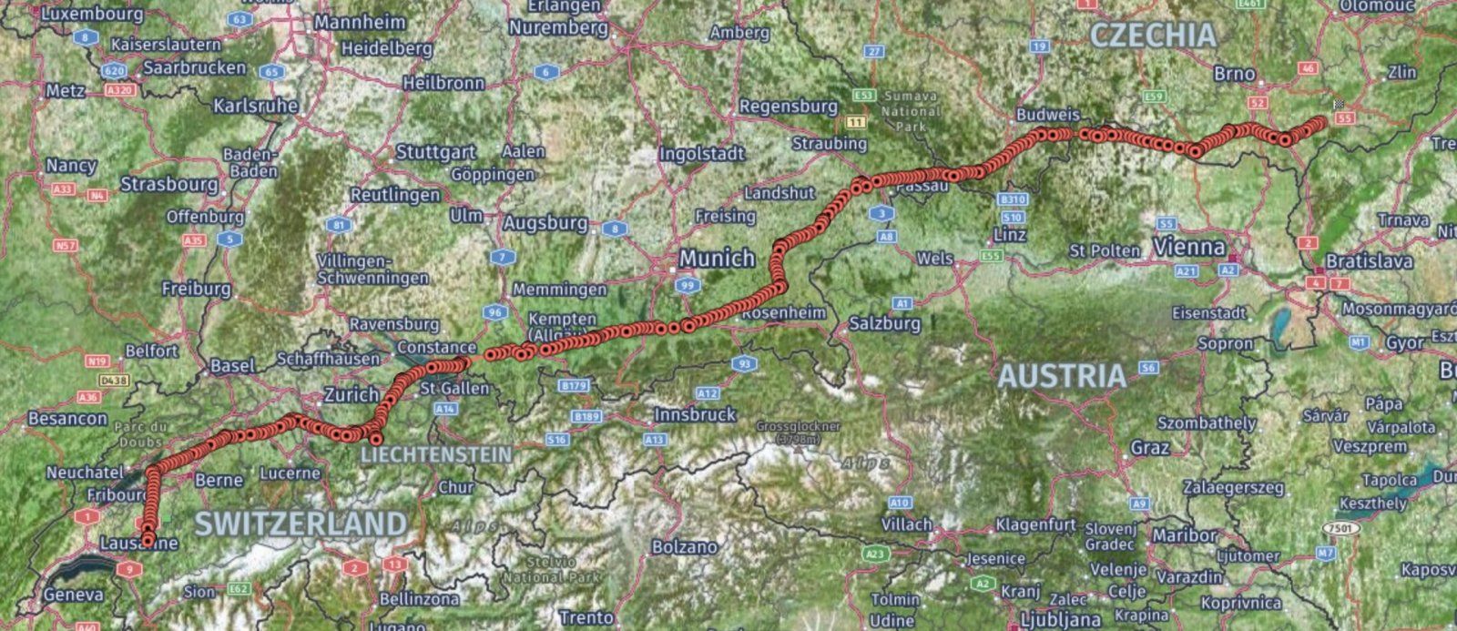

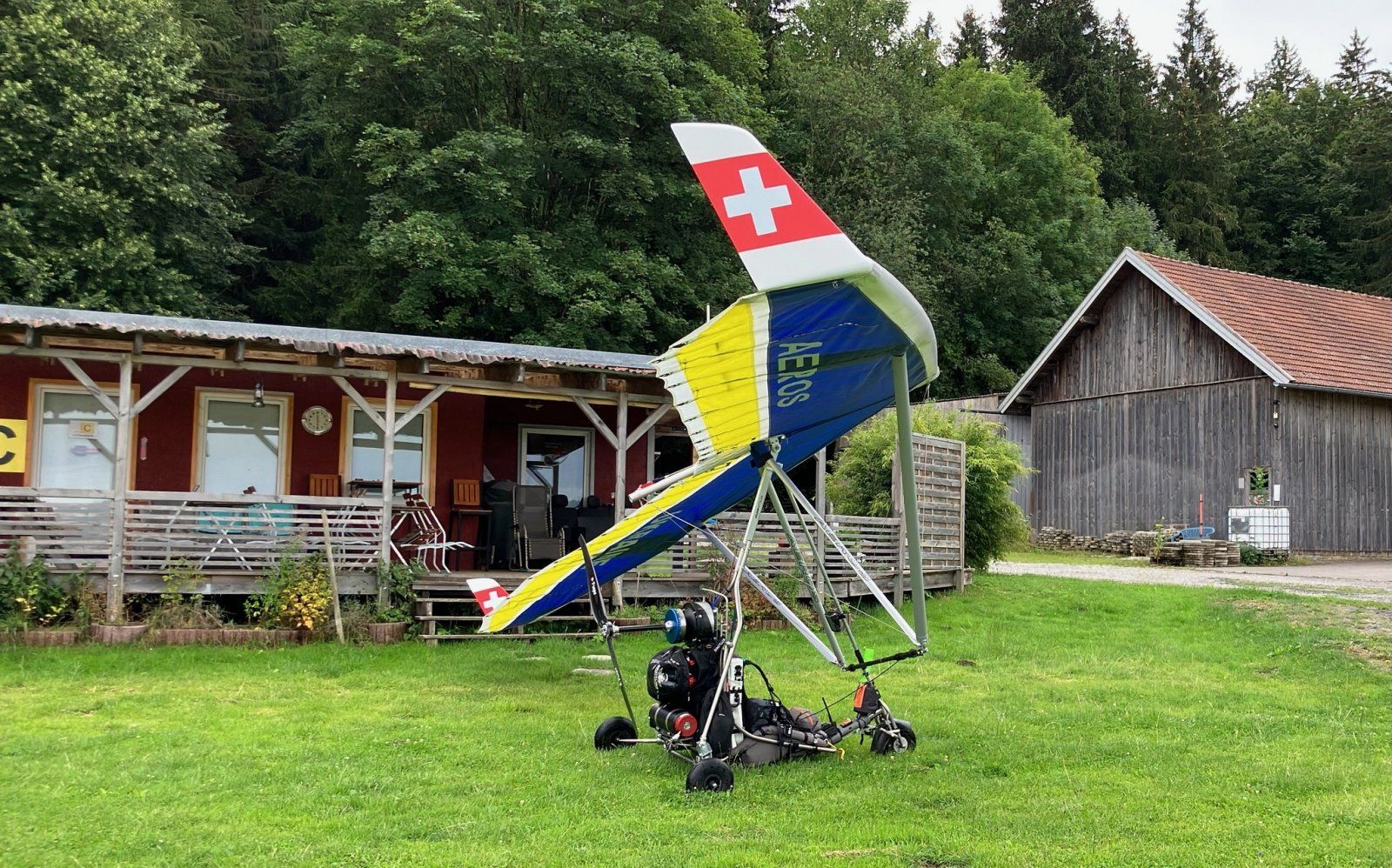

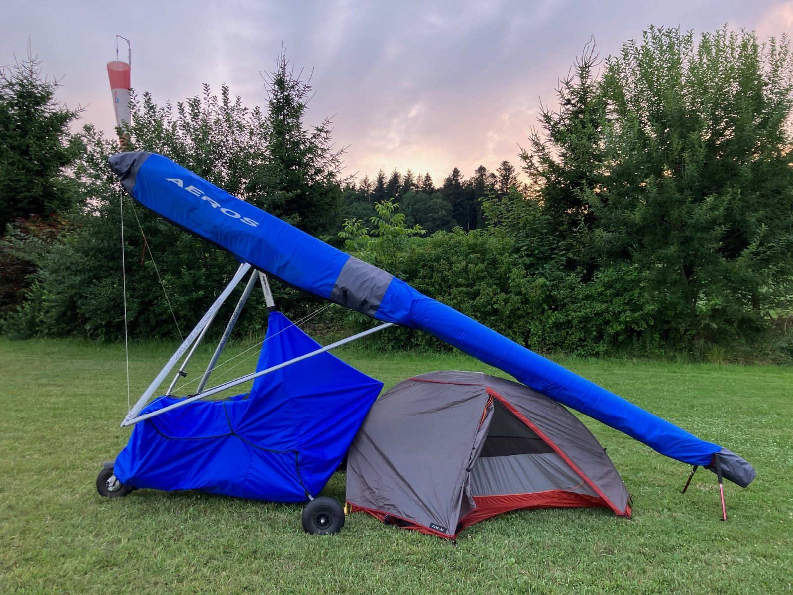

Подниму тему :)
Немного историй из-за бугра, на лицокниге прочёл:
Перелет 1000км на нанотрайке с электрической вмг.
Красиво, интересно :)
1000 km with an electric Microlight.
Yes, it's definitely possible to fly and travel "electric". Taking off from Gruyère (LSGT) in Switzerland on July 15, I arrived in Kyjov in the Czech Republic in 40 days and 22 legs, invited by Marek Wolhard, a paraplegic 3-axis ultralight instructor pilot who had followed @handiflight around the world.
My nano-trike was developed by Ales Hubacek of skyjam-aircraft.com in Zurich. Light and strong, made entirely of titanium, its very low center of gravity makes it very safe to land. 3 batteries of 3.1 kWh each and a 16 kWh motor enable me to fly for 1 hour + 15' reserve at a speed of 60 km/h. All the electrics come from geigerengineering.de, whose reliability has been recognized for many years. A 150 cm E-prop twin-blade after testing several Helix. My wing, received in June, is the excellent Combat-12T from Aeros.
My luggage includes the chargers (4.5 kg), a small tent under my knees, a sleeping bag and mattress inside the double-surface wing and, in a small bag attached to the back above the parachute, some warm clothes (never used), food and drink for 24 hours, plus cables and chargers for the radio, headphones, camera, iPhone, iPad and a mini laptop. All I needed was a 220 v socket to be completely autonomous.
Without mentioning CO2, the main advantages of electric power that I've been experimenting with for over 2 years are reliability due to its simplicity, and silence.
Even though most of the time my wing slept outside (like me) and sometimes in the rain, I never had the slightest breakdown. No spare parts, no consumables and all the tools needed to maintain and repair a combustion engine on a trip. And no worries about fuel quality.
The other advantage, silence, opens up a whole new flying domain. At 1000 ft/ground (and even lower;-) the noise of the propeller is totally inaudible from the ground, so you can fly at an ideal altitude to enjoy the scenery, at the most beautiful hours of the day, without disturbing anyone.
The only well-known drawback is the range. But this should double in the next few years, thanks to developments in the electrification of the automotive industry.
If we take into account maintenance costs and fuel prices, as for cars, over a 10-year lifespan, the overall cost is comparable to that of combustion engines. And if the initial investment is too high, why not share it between 2 or 3 people?
The highlights of my first trip were crossing Bodensee Lake, the green Bavarian countryside, a few unusual airfields, and fortuitous events such as a concert at Vilshofen airport and the Velke Pavlov costume festival.
But, as always, it's the encounters that make the greatest impression. And it doesn't matter whether they're every 50 or 300 km. Thank you Ulrich, Heike, Vratislav, Vladimir, Pavel. Marek and Paola and see you soon, I look forward to your visit.

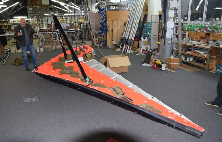

42 км/ч минималка с такой площадью? Никогда не поверю.
дима043
первым делом дельтапланы...
Киров
Вопрос при каком взлетном весе это получено. А так вроде в некоторых странах ограничения касаются не только веса но и минимальной-максимальной скорости.

9ку сертифицируют на 250 кг. Несколько странно зачем на такой большой вес. Для одноместного нанотрайка много. Но для двоих мало и площади и веса даже с лёгкой телегой типа Самсона.
дима043
Киров
250 это взлетный вес включая крыло или вес того что висит на подвесе крыла ? Вероятнее первое и это нифига не много. 115 кг может весить аппарат без топлива и антифриза. Плюс пилот тяжелый ну допустим 110-120 кг (это же как я понял для американского рынка) плюс бензин и охлаждайка. Итого где то 250 и будет. Зачем им терять часть рынка в виде пилотов с лишним весом ?

Да,
В тексте написано MTOW
А на фото испытания голого крыла. Что и вводит в заблуждение. Спрошу

Думаю минимальная 42 это красивая рекламная цифра, но не вранье. Докажу, пример с нанотрайкам 70 суб и с наилегчайшим пилотом. Сколько должен быть пилот? Худенькая девочка 14 лет 30 кило. Шлем, бензин, одежда... все равно меньше 110 взлетный вес не будет. Посчитайте Су. И посчитайте минимальную скорость с тем же Су для заявленного веса 250 кило. Будет уже 63 км/ч. Ближе к правде, не так ли?
Проверочка. С тележкой взлетного веса 370 и крылом Профи ТЛ 14 квадратов реальная скорость срыва 61-63 км/ч Думаю Су мах этих крыльев близки. Нагрузка ТЛ 14 с весом 370 и Нины с весом 250 почти одинаковы. Соответственно скорости срыва с аналогичной нагрузкой тоже близки.
Вывод. Теоретически скорость срыва 42 на Нине достижима, практически в реальной жизни она будет порядка 55 и выше.
