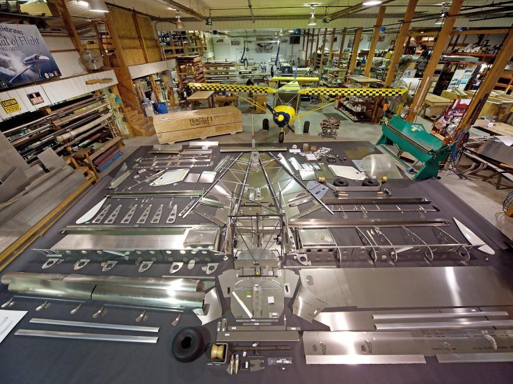

STOL CH 750 Complete Kit
This photo shows the entire STOL CH 750 kit, spread out in the Zenith Aircraft factory.
