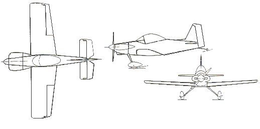

...вот ещё один самолик для гномиков!
Corby CM-2 Specification and Details
Estimated Performances 75hp 85hp
Maximum speed 145kt 148kt
Maximum cruise 130kt 134kt
Economy cruise 120kt 125kt
Max rate climb 1250fpm 1400fpm (330kg/725lbs)
Wing span 5640mm - 18'6"
Wing Area 6.55sqrm - 70sqr ft
Length 4725mm - 15'8"
Fuselage width 610mm - 24"
Overall height 1525mm - 5'
Tailplane span 1980mm - 6'6"
Powerplant 60-90hp -66-77kgmax
(V@, Rotax 912, Jabiru 75)
Empty weight 227kg - 500lbs
Pilot - Baggage 90kg - 200lbs
Fuel 60l-13gals 43kgs- 95lbs
Oil 2kgs - 5lbs
Total weight Aerobatic - 340kg-750lbs
Total weight x country - 363kg - 800lbs
Stress Factors (+6,-3)G
Fully aerobatical 340kv-750lbs
