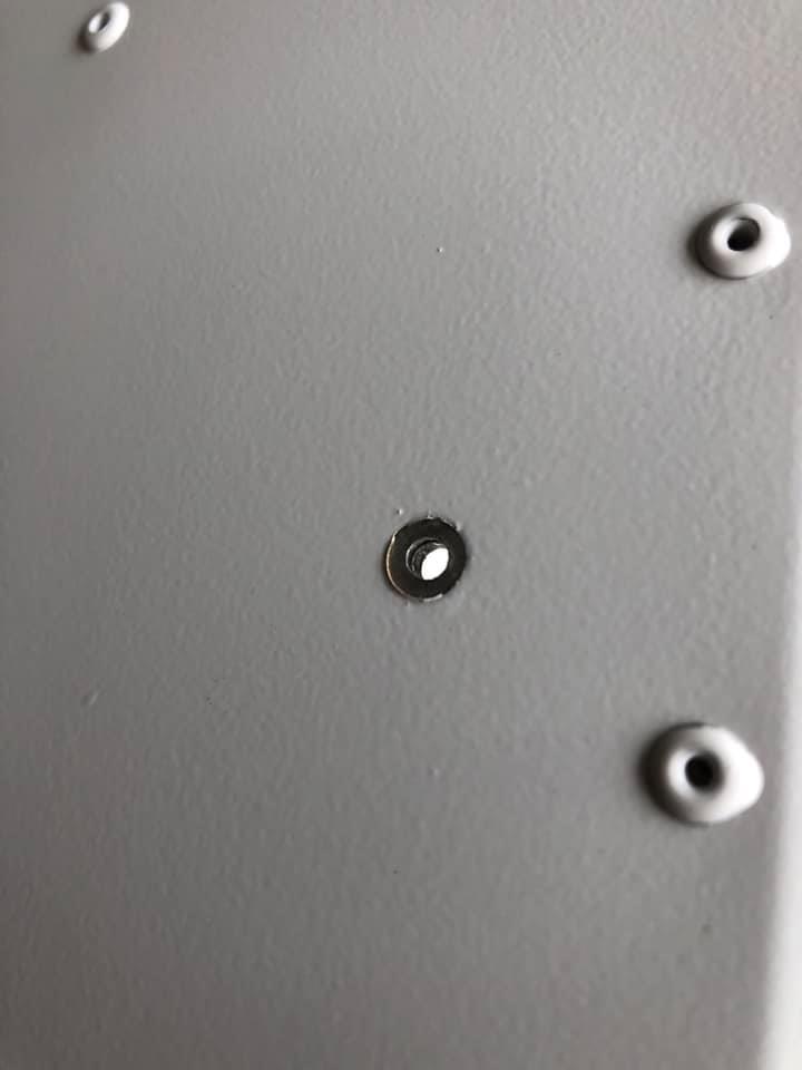

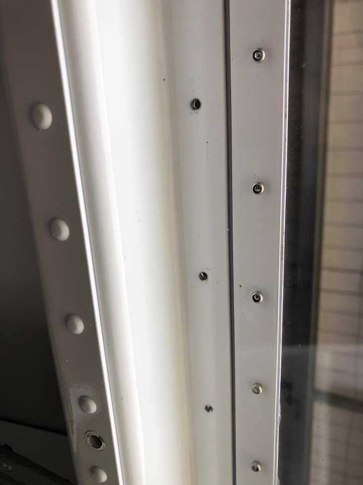

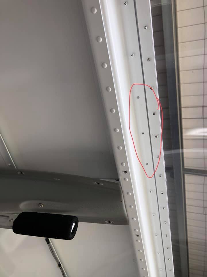

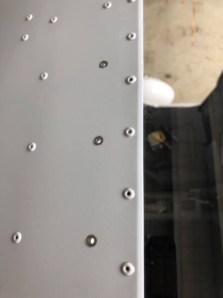

У парня из Новой Зеландии срезает заклепки:
I own and operate an A32 in New Zealand. Build #10 was manufactured around mid-2015. It now has around 280hrs of time. In October 2019, I noticed 3 failed rivets in a line, which attaches the forward compression spar to the inner upper cockpit fuselage skin. The photos show this clearly. After bringing this to the attention of the NZ agent as well as the factory in Kiev, their remedy was to simply drill out the rivet remnants and replace with new ones, “keeping an eye on that area,” whatever that means. Well, my eye has found another identically failed rivet right next to the line of 3 previously failed rivets. I’m expected to be told the same ‘remedial action’ as before but surely there is something else going on there? In October last year, I was informed that there “has never been any other A32 aircraft experiencing this issue” and I am a bit reluctant to accept this answer, hence my post here. Feel free to PM me for more info if required. I love my A32 and the performance and experience is absolutely awesome. I fly for sheer pleasure and never expose the aircraft to anywhere close to its performance limits and I’m the only one who flies it. I’m simply fearful of ignoring a potentially vital bit of info that can be useful to other folk. I would seriously suggest the next time you are at your aircraft, to have a very close look at these rivets from the outside. It’s the line of rivets immediately aft of the windshield fixing rivets. The heads of the failed rivets sheared off flush and cleanly with the upper skin surface, as if they were surgically cut off. Pretty weird.
