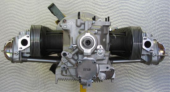

Двигатель Volkswagen
на рисунках выше видно. что максимум крутящего момента у промышленного варианта (это он) мотра Тип 1 1584см3 находится в диапазоне 2000-2200об/мин.

The problem I have here is that you've got to spin a 1600cc engine nearly five
thousand rpm to see an output of sixty horsepower.  And you can only do that
for about a minute before the CHT runs into the red and you have to let it cool
down for half an hour or so before you do another pull.  Fitted with a blower,
tightly shrouded, and installed in a car, you can get away with calling it a
sixty horsepower engine.  But a car engine isn't an airplane engine.
The reality of airplane engines is conversion of torque into thrust.  You may
insert horsepower into that equation if you wish but it serves no practical
purpose. When the task is generating thrust using a fan bolted directly to the
crankshaft, torque is the critical factor.
For an internal combustion engine, particularly a carburetted Otto-cycle
engine, maximum torque occurs at the point of maximum volumetric efficiency.
You can fiddle with the cam and induction system ‘til the cows come home
trying to improve the VE but with a displacement of only 96 cubic inches,
normal aspiration and a compression ratio you can live with, lighting the fire
is going to give you a certain quanta of heat and that's going to raise the
pressure in the combustion chamber to a certain level and it's that pressure -
you may call it BMEP if you wish - that turns the crankshaft. For a 1600cc
engine and that particular set of conditions, you're never going to see more
than about 80 lb-ft of torque.  And at a fairly low rpm too, which ain't all
that bad because props are more efficient at lower speeds. (When the object is
to produce thrust, if you're honest the bottom line has to include the
propeller's efficiency factor.)
Eighty ft-lbs of torque at prop speed is closer to 40 horsepower than sixty.

See that 2180cc VW hanging on the test stand out behind the shop?  That's my
Hangar Queen.  Since 1968 or thereabouts she's racked up better than fifteen
hundred noisy hours testing everything you've ever heard of and a lot that you
haven't.  (I've torn-down the poor thing so many times I've lost track.)  See
that box of wiggle sticks over there in the corner?  Dig around, you'll find
stock VW cams along with several from Engle, Web and  Schneider, both solids
and juicers, even a couple of special grinds I worked up myself, all chuggers
designed to give maximum torque across an RPM practical for a propeller.  Forty
years of VW engine building experience, nearly two thousand hours of testing -
enough gasoline to float a boat - and the best I can do is about 115 lb-ft of
torque out of that thing.  That's about 55hp.  At prop speeds.   Not 80 or 100
like all those other guys.
Of course, those hours of testing are comparing apples to apples. Or rather,
torque to torque.  And at speeds suitable for slinging a prop efficiently.  On
that basis I think it's fair to say I've managed to do about as well as
Continental or Lycoming when it comes to the power output of a small air-cooled
engine.  The 2180, which is about 133cid, produces about 115 lb-ft of torque.
The A65's 171 cubic inches cranked out about 145, the A40's 112 cubes managed
about 90.  And I've gotten as much as 80 ft-lbs out of a sorta-stock 1600
turning about 2600 rpm.   But I've obviously got a long way to go to catch up
to those other VW engine builders.  Based on their published figures volumetric
efficiencies regularly exceed 100%, specific fuel consumption on the order of
three tenths of a pound per horsepower-hour is not uncommon and pulling nearly
one horsepower per cubic inch for a TBO of 1500 hours is old hat.  Truly
incredible engines.

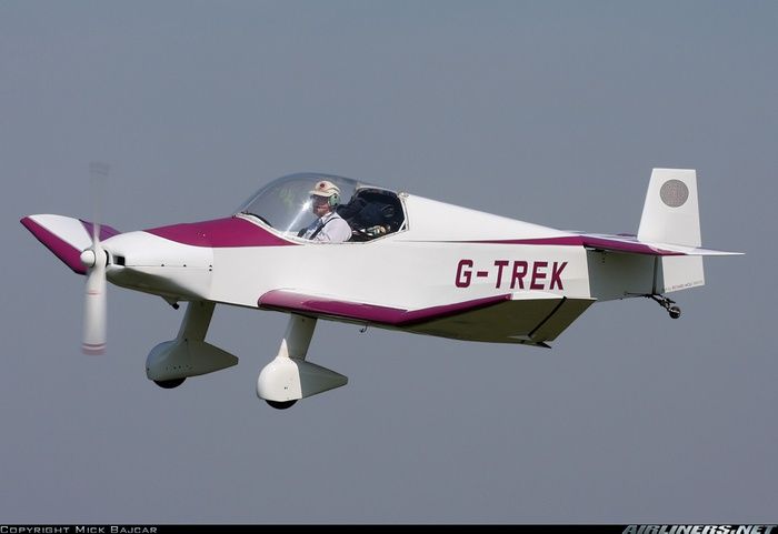

Денис, может этот совет не мне предлагаешь,я вообще-то ищу информацию о VW не на Пайпер,а на Jodel D18,и поэтому хотел бы что бы ты включился в дискуссию о применении этого мотора на более-менее скоростных аппаратах с крейсерскими V около 150-170 км.ч.
    21,8 КБ · Просмотры: 153
Прототип D18 (DC1) полетел с 1600-кубовым Жуком.
Этому самолету достаточно 50л.с. при полетной массе не более 450кг.
Малый размах крыла (7.5м) и низкопланная схема определяют большую длину взлетной и посадочной дистанций, которые невозможно существенно сократить никакими мерами, в том числе и увеличением мощности двигателя. С мотором объемом 1835 и более см3 будет главным образом расти крейсерская скорость на высоте. Однако нужно удержать в ежовых рукавицах вес с любым двигателем. Диаметр винта на D-18 обычно бывает 1.3-1.4м и дальнейшее его увеличение также бесполезно.
Смотрел на сайтах, первое самое большое замечание, литые коленвалы, ни в коем случае нельзя применять,
Александр,Вы это про те движки ,что о каких я говорил?
Да, на одном из сайтов прямо было указанно что коленвал литой. Вам надо списаться с ними и уточнили про коленвал, спросите какая разница будет в цене.
Вы хотите сказать ,что кованный к.в., это как бы опция в этих моторах,и ничего страшного, если эти двигатели окажутся с литым,есть возможность замены?А кованные к.в. выпускаются только для авиации, или на" наземные" нужды тоже?
    36,5 КБ · Просмотры: 216
Не существует на данный двигатель запчастей для авиации если это не Aerovee или Revmaster или любой другой который имеет в своем составе что либо специфически разработанный под него. Литой коленвал на тип1 это как правило, более дорогая опция это кованный коленвал, на конверсиях применяют кованные.
Родной немецкий коленвал Тип1 кованый стальной. Эти коленвалы были выпущены в больших количествах и до сих пор доступны за недорогие деньги.
Литой чугунный коленвал- мексиканский. Поэтому он и ставился на моторах выпущенных на заводе в Пуэбло, в Мексике.

Относительно вз.-пос. характеристик, D18 меня вполне устраивает.Вообще,по практическому опыту пришёл к выводу ,если длина разбега не превышает 200м..а в горизонте самолёт не напрягаясь едет с V=около 150-170км.ч.,то озадачивать себя улучшением этих характеристик в принципе не зачем.Хотя, кому как,предела совершенству,как известно не бывает.
А вот насчёт Ф. винта,если можно поподробнее,тем более,что у многих  в тех.данных указывался Ф.1500,наVW 1830.Денис,можешь ты на вскидку определить N конкретно вот этого мотора объёмом2020сс при3400 об.мин.?Статика,естественно меня не интересует.
Мощность мотора по общему виду, тем более. без таких существенно влияющих на нее вещей, как впускной коллектор и карбюратор, определить невозможно. Приближенно с объема 2л можно ожидать от 60 до 70л.с. Что достаточно с избытком.
Диаметр винта 1.5м определяется скоростью концов лопастей (283м/с при 3600об/мин). Деревянные винты с узкими эллитическими концами лопастей, как СДВ-1 при такой скорости еще не имеют заметных волновых потерь даже при малом относительном шаге. Это можно заметить даже на слух - шорох мышей, а не вопль пилорамы. Однако, на скоростном самолете рационально уменьшать диаметр винта, чтобы возрос потребный относительный шаг. Критерий расчета - раскрутка оборотов на полном газу в диапазон еот статики до 0.9 ожидаемой максимальной скорости ГП  у земли не должна быть более 10-12%, тогд крейсерский винт будет одновремено давать хорошую располагаемую мощность на взлете и в наборе высоты. Наконец, всегда целесообразно делать шасси как можно ниже.  Если есть возможность увеличить диаметр винта при достаточно большом относительном шаге, но для этого нужно отращивать ножки, то делать этого не следует.
