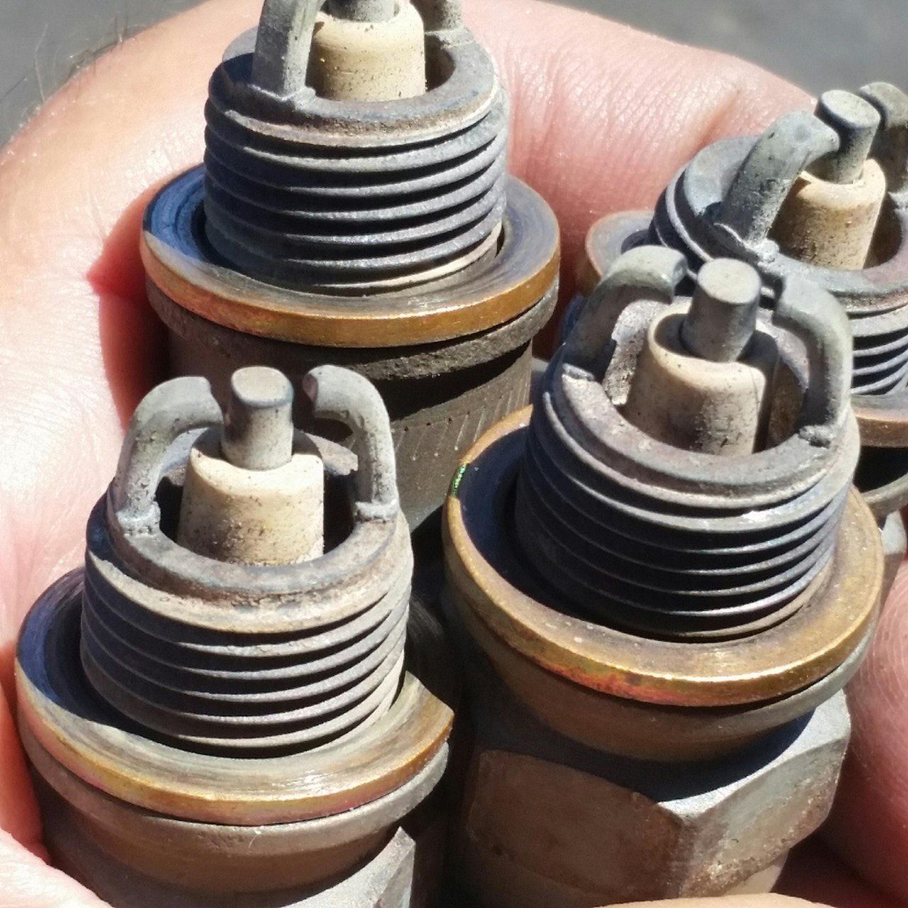

Taking a couple of maintenance days ....... Checked compression (76/80), plugs look good, (need to be re-gapped), changed oil and filter. Checked valve clearance.
This engine (O-235) has solid lifters and should be checked every 100 hours. .007 - .009 as required. Sorry, I don't know the millimeter equivalent.

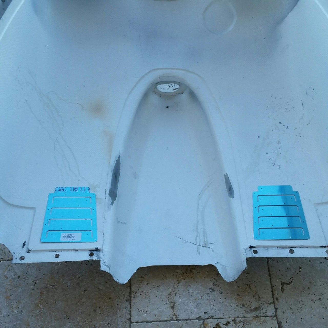

To be more specific, I have been having low engine driven fuel pump issues since the first flight. Engine never hesitated, but last flight it quit.
Only for 10 seconds, long enough to switch tanks and turn on the electric pump, but sure enough, it QUIT. Really gets your attention.
If you ask Van's, there are no cooling or vapor lock issues ....... yet he offers for sale a cowling louver kit for 6,7,8,9 aircraft. I will install it this week and will report my results here.
If you want to know more, search Van's Aircraft OP-58 on the web.
