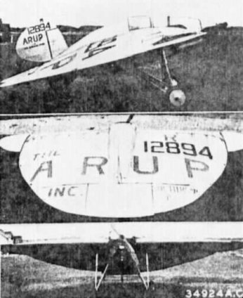

Вот вам киноролик для затравки на "Arup" http://www.youtube.com/watch?v=Nxz1UF67EQI
Для компановочного "проигрывания" модельные чертежи:
http://www.theplanpage.com/Months/2503/arup.htm
Общее ознакомление с нетрадиционными крыльями данного типа:
http://www.nurflugel.com/Nurflugel/n_o_d/weird_04.htm
Ну и далее перепечатка:
  ARUP TAILLESS MONOPLANE.  Jane's "All The World's Aircraft" (1935 edition) describes this airplane as "a two-seat machine with a 70 h.p. LeBlond engine....This has a high aspect ratio wing with straight leading-edge and built in nacelle...." In plan form, the wing is almost semi-circular.
      An Air Force film "Aeronautical Oddities", shows this airplane in flight at South Bend, Indiana and in some attitudes appears identical to the photograph included in Appendix "C"; as Figure 4. Although it is believed that the ARUP Manufacturing Co. is no longer in existence, it is possible that later models of this or similar U.S. civil aircraft may have been observed.
Span  22 feet
Length 19 feet
Power Plant 1 LeBlond engine 70 h.p. (вероятно первый был с 40 л.с.)
Max. Speed 86 miles per hour
http://good-times.webshots.com/photo/2381170270032408188lnwbbn
http://good-times.webshots.com/photo/2681194750032408188wUZNzD
http://good-times.webshots.com/photo/2111924420032408188VvZBex
    49,7 КБ · Просмотры: 135
