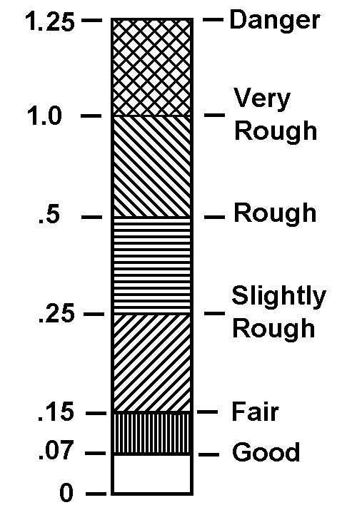

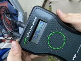

Вообще-то балансировка до 0,07 это не айс, добалансируйте хотя бы до 0,02-0,03
The industry standard after balance limit is 0.15 IPS, this where your average balance shop will say it's "good enough".
Vibration Range Limits
DANGER — 1.25 Inches Per Second (IPS) Peak Amplitude. The propeller should be removed and a static balance performed.
VERY ROUGH — 1.00 Inches Per Second (IPS) Peak Amplitude. Propeller can be dynamically balanced; however a large amount of weight will be required. A propeller static balance is recommended. Operation at this vibration level could cause damage.
ROUGH --- 0.50 Inches Per Second (IPS) Peak Amplitude. Propeller definitely requires dynamic balance. Long term operation at this vibration level could cause excessive wear.
SLIGHTLY ROUGH -- 0.25 Inches Per Second (IPS) Peak Amplitude. Dynamic balance will improve passenger comfort.
FAIR---- 0.15 Inches Per Second (IPS) Peak Amplitude. This is the maximum acceptable vibration level after dynamic balancing.
GOOD ---- 0.07 Inches Per Second (IPS) Peak Amplitude. Vibration levels below 0.07 will not be detectable by pilots or passengers.

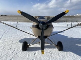

новый винт ВК7У.
новые ВВ провода Subaru.
выполнена форма 100 часов (масла, фильтра, свечи, профилактика топливной, профилактика заднего колеса).
цена 1.2
