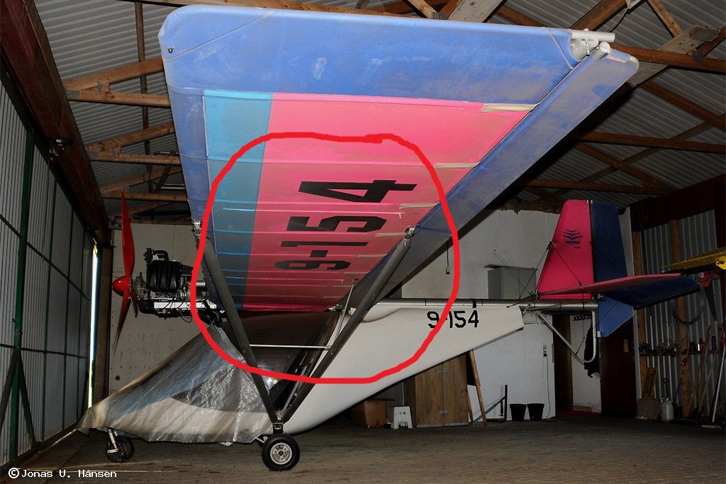

Всем доброго дня ! Кто сможет объяснить, как шнуруется(стягивается ) обшивка крыльев между собой ? Есть какая то схема или хитрость? Решил поменять веревки, (местами перетираются), расшнуровал и возник , собственно , вопрос- а как обратно зашнуровать ?
подскажите если кто знает.

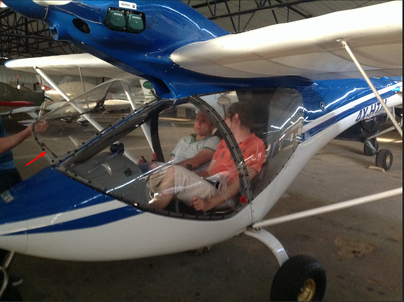

Привет. К сожалению, я не говорю по-русски. Я хотел бы попросить помощи с самолетом JetFox 91. Как можно исправить дверь, чтобы она не закрывалась? Каковы варианты открытой поддержки? Спасибо
Hi, if it easier for you to speak English you may try to explain your problem in English...
I see... There is no such an option on 91's but you may look on how it is performed on 97's. I've found a shoot from my collection, the best I have to demonstrate you an idea.
    1,9 МБ · Просмотры: 317
Yes, I want that too. I need a better picture.
Sorry, I don't have a better one (... Try to find out from the owners. As I know, 91's don't have anything like that except those rear whose owners compilate this by their own. But if fortunately you have anybody who owns 97's near you, ask him to give you a close look... As far as this is russian forum you'll hardly find here 97's owner. I knew only one of 97's that was imported to russia. RA-0192A... I live in Israel, we have a number of 97's still drilling holes on a sky here ). If I meet any of their owners I may ask for advice for you. If you want, find me on facebook Vitaly Basenok
We don't have such a plane. I saw a picture in an old post here. I'm writing on Facebook, any help would be appreciated. Thank you
