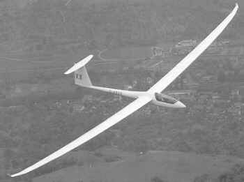

Schempp-Hirth Nimbus 4
Specifications
Span 26.4 m./ 86.6 ft
Area 17.86 sq. m. / 192.2 sq.ft.
Aspect ratio 38.8
Empty weight 470 kg. / 1,036 lb.
Payload 280 kg. / 617 lb.
Water ballast 300 kg / 662 lb
Gross weight 750 kg. / 1,653 lb.
Wing loading 41.99 kg. / sq. m. / 8.60 lb. / sq. ft.
Structure CFRP/ Kevlar
Performance
L/D max. 60 110 kph / 59 kt / 68 mph
Min. sink 0.38 m/s / 1.25 fps / 0.74 kt
78 kph / 42 kt / 49 mph
    5,4 КБ · Просмотры: 174
