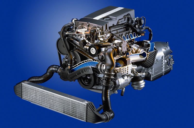

DiesOtto и аналоги вероятно пойдут в серию в 2014-15 году.
Дата вопрос экономистов и маркетологов.
BlueTec пошел в серию в 2010 и несколько лет технологию менять не будут (на картинке).
Вы Даймлера не забижайте 🙂 они немного в моторах понимают и первые в мире сделали:
- Hans Scherenberg, a Daimler-Benz engineer at the time, assumed responsibility for the gasoline injection project launched in 1934, and only three years later, in November 1937, large-scale production of the DB 601 A, a twelve-cylinder aero engine – the first with gasoline injection – began. It was clearly more powerful and economical than the carburetor version.
- Scherenberg developed the gasoline injection system for earth-bound vehicles to production standards. The legendary Mercedes-Benz 300 SL, launched in 1954, was the world’s first production car with a four-stroke engine with gasoline injection. The Gullwing coupe with its unmistakable design was powered by a 215-hp (158-kW) six-cylinder engine for top speeds up to 260 km/h.
- From 1957, engine operation was determined by a new technology: gasoline injection became indirect – intermittent manifold injection, to be precise: the atomized fuel was injection into the intake manifold rather than directly into the combustion chamber. This system was first used in the Mercedes-Benz 300 d, the last of the four versions from the 300 series built until 1962.
пропускаю десяток историческиз улучшений
- 2002 The story of direct gasoline injection at Mercedes-Benz was continued at the end of 2002 with the introduction of a new 1.8-liter, four-cylinder CGI engine. CGI stands for Stratified Charge Gasoline Injection. This is the first engine in the world to utilize the potential savings of pioneering direct injection technology combined with supercharging, charge air cooling and mass balancing.
- 2005 In 2005, Mercedes-Benz introduced the new diesel technology BLUETEC. Using the Selective Catalytic Reduction (SCR) process it reduces nitrogen oxides in the exhaust gases of diesel engines by around 80 percent.
- 2007 The decisive steps in the development of the diesel engine to its present-day standard – combining dynamic performance with low fuel consumption – were made possible by turbocharging and common rail direct injection, both pioneering inventions of Mercedes-Benz.

Главная фича DiesOtto - при малых и средних оборотах бензиновая смесь будет зажигаться при помощи сжатия, а не от искры. Регулирование опережение зажигания исчезнет. Мощность искры уменьшится. Токсичность выхлопа уменьшится, экономичность вырастет. У всех конкурентов аналогов близкая идеология. Это главное, остальное мелочи.
Только степень сжатия регулируют все по разному - кто головку шевелит, кто камеру сгорания, кто длиной шатуна, кто опорами коленвала... кто наддувом играет по хитрому.
