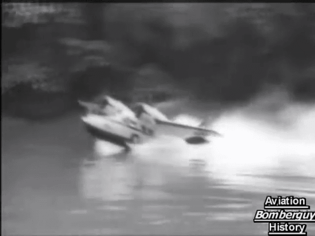

Наткнулся в сети на склейку хроники, понравился капитальный барс на Си Би, смотреть вторую минуту http://youtu.be/n82nN_lqn58

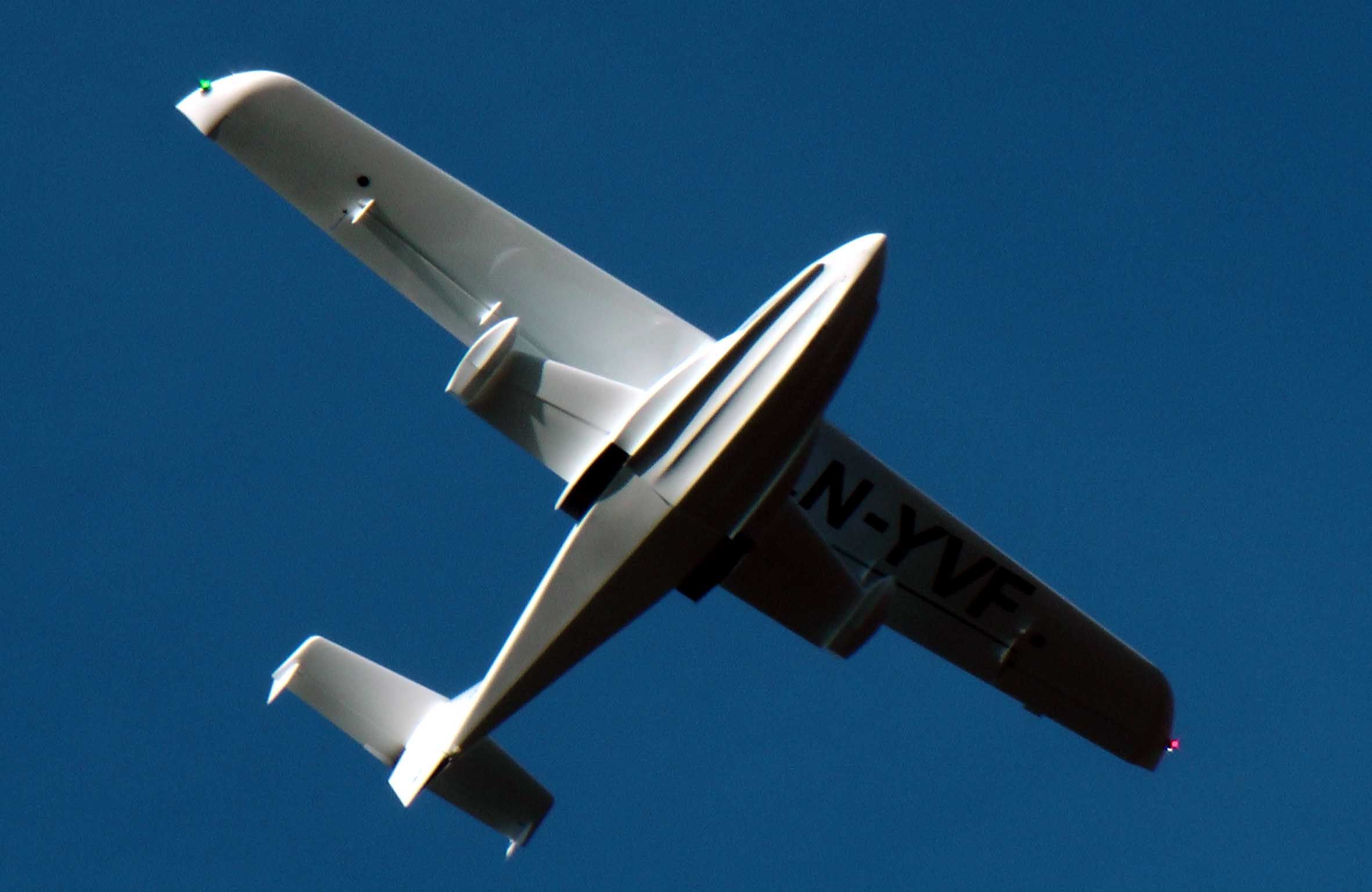

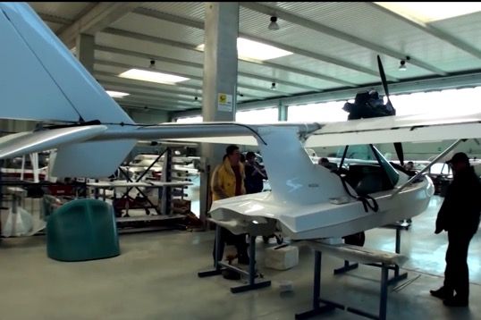

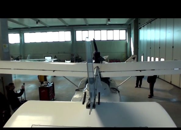

Обнаружил вот такую норвежско-чешскую композитную амфибию. Была представлена на недавно прошедшей AERO 2016 в Германии.
http://www.atecaircraft.eu/en/planes/omsider-amphibian/
Omsider amphibian - ATEC aircraft  http://www.atecaircraft.eu/en/news/next-omsider-in-norway/
http://www.flyingboats.ca/Omsider-Norway.htm
https://www.youtube.com/watch?v=Ra7fyPKvGNw
https://www.youtube.com/watch?v=Lrj2QE9p4Bo
Wingspan 11m, Length 6,8m, Heigth 2m
Empty Weight 290kg, Max Weight 495kg, Payload 205kg
Cruise speed 200km/h, Max speed 270km/h, Minimum speed 65km/h, L/D 20:1
Take off land 100m, Take off water 150m, Climb 4m/s, Minimum sink 1m/s
Engine 60hp, HKS 700E, 2 cyl 4 stroke boxer, consumtion 6-8 l/h

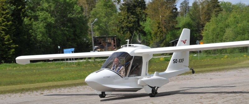

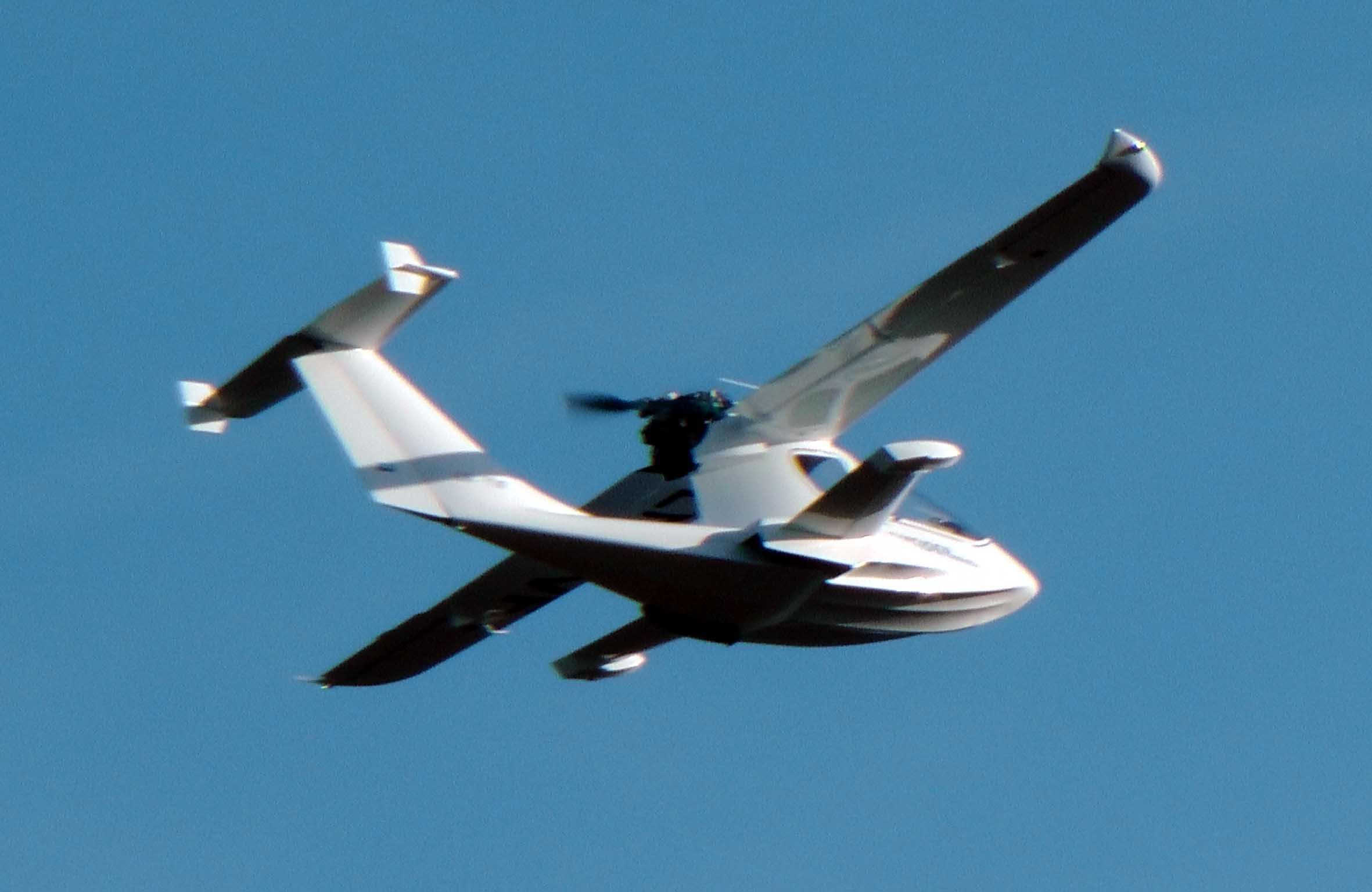

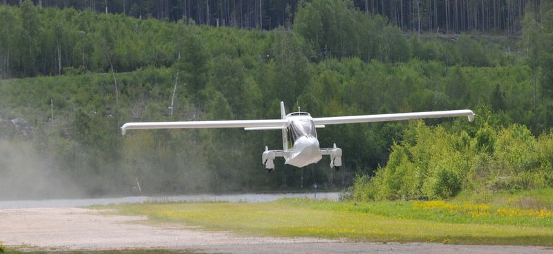

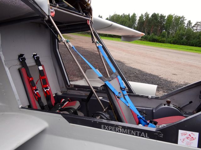

Вот еще шведская игрушка LN-3 Seagull.
http://www.flygfabriken.com/en/image-gallery/
https://www.youtube.com/watch?v=nANPx0HHZRs
https://www.youtube.com/watch?v=xBOCz1jVjxE
https://www.youtube.com/watch?v=-CCoXOH1uCA
Max take off weight      600 kg (1,323 lbs.)
Empty weight      325-350 kg (716-772 lbs.)
Fuel quantity      2 x 57 L (30 US Gallons)
Max fuel load      82 kg (181 lbs.)
Max payload (including fuel)      275-250 kg (606-551 lbs.)
Load factors (at weight 540 kg)      +6 -3 G
Load factors (at weight 600 kg)      +5.4 -2.7 G
Wing span      10,830 mm (35 ft 7 in.)
Fuselage
Fuselage length      6,720 mm (22 ft 1 in.)
Fuselage max width      760 mm (30 in.)
Fuselage height (fuselage horizontal)      2,150 mm (85 in.)
Power Plant
Make and model      Rotax 914
Performance
Max horizontal speed (540 kg) gnd. level      222 km/hr (120 kt.)
Cruise speed 65% power      194 km/hr (105 kt.)
Stall speed (540 kg) clean      80 km/hr (43 kt.)
Stall speed (540 kg) flaps and gear      70 km/hr (38 kt.)
Max climb rate (540 kg)      6 m/s (1200 ft/min.)
Max maneuver speed (540 kg)      213 km/hr (115 kt.)
Speed never exceed (approx.)      282 km/hr (152 kt.)
Endurance
Endurance cruise speed 65%      6.3 hours without reserve
Range at cruise speed 65%      1,200 km (650 nautical miles)
Mileage      8 liter/100 km (29 mpg)

Омсайдер - вполне реалный самолет. Я сам такое что-то рисовал. А вот Шведы меня поражают своим упорством - эта штука впервые появилась лет 10 назад. Понятно что бестолковый аэроплан - поплавки маленькие и очень низко - волной захлестывает. Залезать в заднюю кабину - просто цирк. Тяжелый, неаэродинамичный - нет все долбят и долбят . Откуда у людей бабки? Вон саратовский инвалид за бесплатно свои самолеты строит.

АВИ-большой респект несомненно! 😎 Но вот шведы тужаться сделать скоростную амфибию, каковых у нас до сих пор не было, оттого и обжимают лодку и поплавки. У Четвериковских лодок тоже были проблемы с мореходностью, когда он за скоростью гнался. С другой стороны...зачем шведам скорость? Только раскочегарил, Швеция уже кончилась, ну и Дания заодно. ;D
С этого места, плиз, поподробнее. О чем речь?
Если LN-3 Seagull, то в нём претензий на скорость не наблюдаю.
Потому что бестолковый. Ребята мало летали на воде и плохо себе представляют эксплуатацию. ДА там и лета нет.
Просто эта схема с тандемной посадкой позволяет обжать мидель и сделать более скоростной самолет. При правильном подходе.
