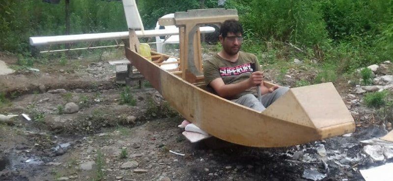

АртёмWell, almost built. You still have a lot of things to do, but if you want to cope, the main thing is not to rush. And if there is a desire, immediately put a nose stand, then you will understand why.
Yes, there is still a lot of work to be done
And if there is a desire, immediately put a nose stand, then you will understand why. !!
I did not understand. Thank you. Explain with a photo
Unfortunately, there is no photo, but my tester was disappointed with the lowering of the nose when the gas was sharp, only the smooth giving of gas saved the situation on the run-up.
